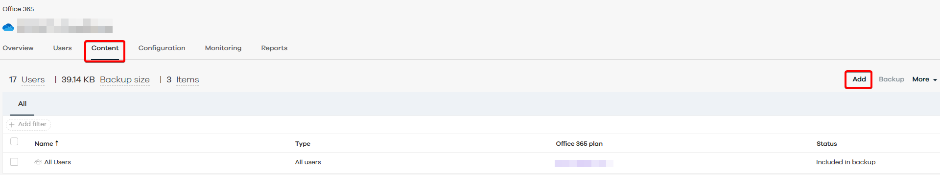

Best answer by Ryan Carr
Hi Dennis
It reads like the problem is with your content tab. Our docs has steps on adding content that can help
I would recommend to check your Content tab and make sure you have something in there that Commvault can search against. If its empty look to use the add button and select the type of content.

Hi Dennis
