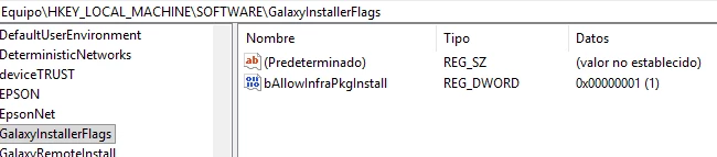

In 11.40 you need to enable a key to install Web Server on a Windows machine, although you haven’t mentioned the operating system.
https://documentation.commvault.com/11.40/software/enabling_windows_installations_for_commvault.html

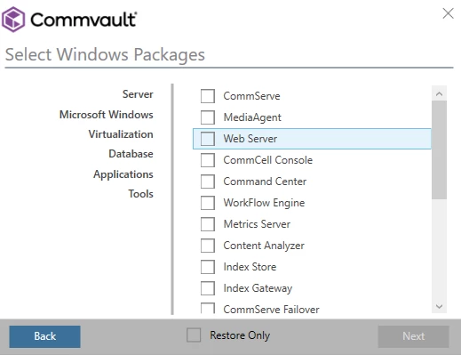

As it requires an interactive install, you need to use bootstrap to download the software for Web Server component as it downloads the SQL Express binaries that are used when installing the Web server.
After adding the key the Web server will be allowed to be selected from the Server list:

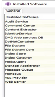

Forum|alt.badge.img
  • Author
  • Apprentice
  • February 16, 2026
Old server Windows 2016

I have enabled the key in the windows machine where I run the bootstrap (Download manager) that allows me to select the packages for Web server from the list of packages to download (as I showed in my screenshot).
Once packages for Web server are downloaded you can copy the binaries to the Web server machine to run the install interactively. Web Server cannot be installed from the console as it installs a SQL Express.

Key enabled in registry in my laptop:

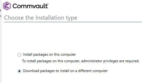

Run the Commvault_Media_11_40.exe bootstrap and selected download packages → Windowsx64 → Selected MR version, in my case latest → Advanced to select the package:
And Web Server is showing in the list to be selected:
