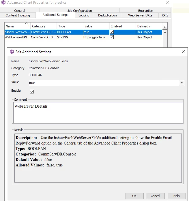

@Tyo
Looks like the options are hidden by default for some reason. I’ll get confirmation.
In the meantime, could you please add the following additional setting to your Commserve Client properties then re-try?
https://documentation.commvault.com/additionalsetting/details?name=%22bshowExchWebServerFields%22&id=10564
I tested this and it worked:
You need to then restart the JAVA console for it to be visible.
Regards,
Chris
