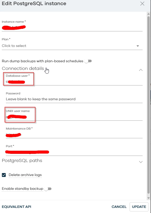

@Alex Deaconu i maade seperate use in postgresql to connect to db and make back, but its not existed unix user. sso like here i caan usse DB user which i seperate created and unix user can be postgres because its created when installing postgrsql, right?
Alex Deaconu
Vaulter
Forum|alt.badge.img+4
  • Vaulter
  • December 10, 2025
Yes. You can leave that ‘UNIX user name’ empty, and the backup will use the user under which the CV iDA is running, usually root. Otherwise, if the user ‘postgres’ is permitted authentication, as in, its shell is not ‘false’, or ‘nologin’, then you could use this, or whichever user the PostgreSql Services is running under.
Typical configurations leave the OS user empty. It has some uses, like restricting local Unix Socket login to PG from root, and only allowing from a certain user, and running scripts as the impersonated user. The ‘UNIX user name’ is not something most people use.
