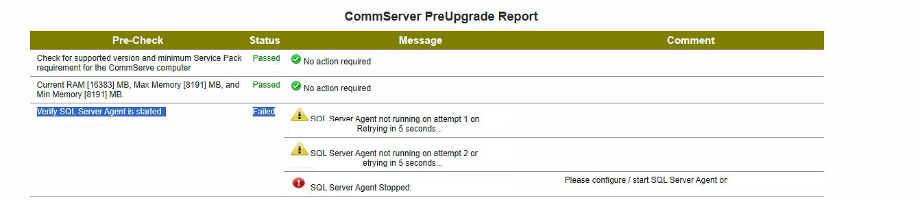

I would like to update CommCell from 11.40.xx to 11.44.xx.
Unfortunately, I keep running into this problem (with several customers already).
Even though the service is running.

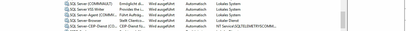

Out Put ist:
PS C:\Windows\system32> Get-Service *SQL*Agent*
Status   Name               DisplayName
Running  SQLAgent$COMMVAULT SQL Server-Agent (COMMVAULT)
Is the “hyphen” in Server-Agent the problem?
