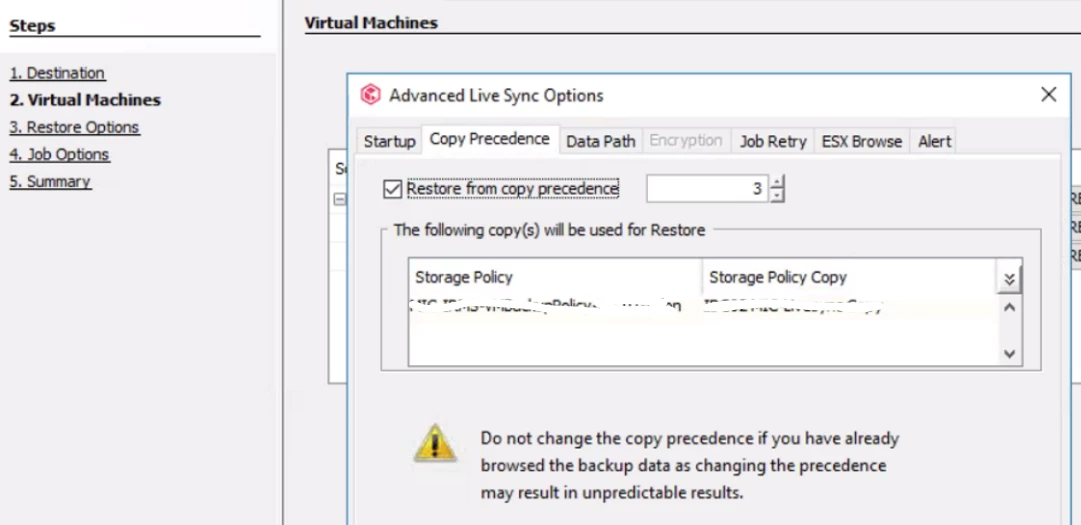

We can configure the Live sync group where we give the precedence.
Until the respective copies are not completed the live sync won’t work.
If you have selected Aux copy in above snip shown so until the AUX copy is completed the live sync won’t work.
So to answer your query there is no way to prioritize first Full and then incremental.
